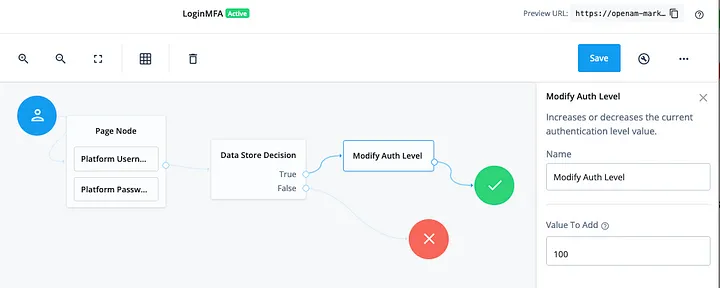

LoginMFA
This journey will include a node to add + 100 to the Auth Level. After successfully traversing the journey, you will have a session with an Auth Level of 100. In your environment this will likely be more complex with MFA nodes, however for simplicity we will just ensure the Auth Level is set correctly.
