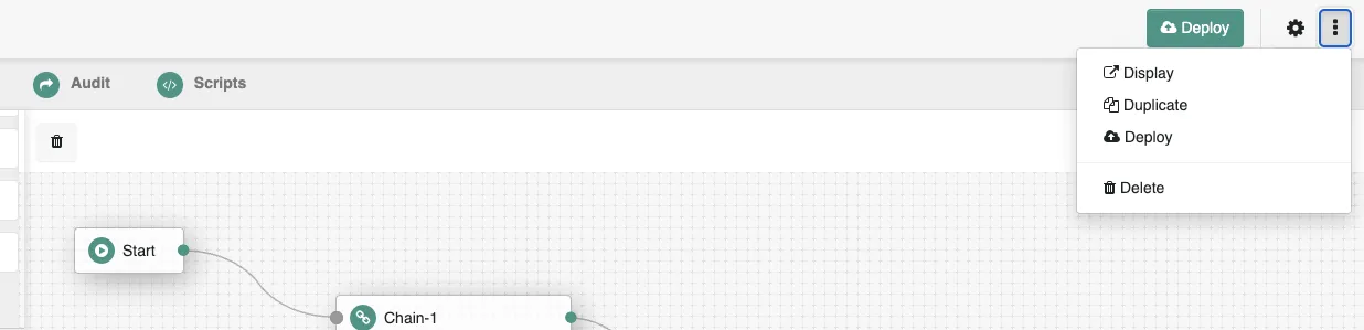

TIP: When I need to do this, I usually define the full route in Studio, then select the display option from the “hamburger”. This will show the route in JSON. From here, I can simply add my additional configuration and place the resulting file into .openig/config/routes.
Note: After files are place in openig/config/routes, you may have to restart IG for the routes to be loaded correctly.
