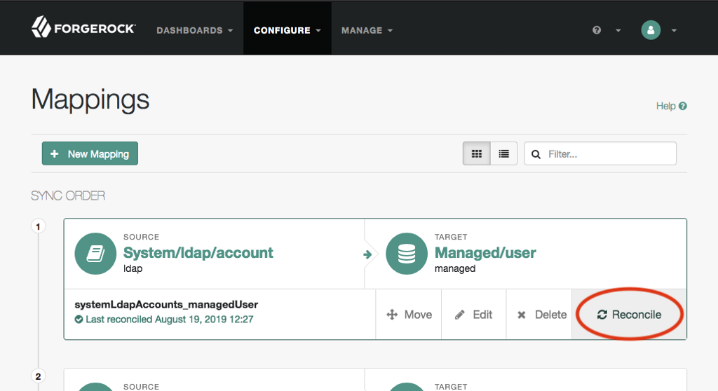

Reconcile DS Shared Repository
We will now run a reconciliation to pull users from the DS shared repository into IDM.
Browse to Configure, then Mappings then on the System/ldap/account→Mananged/user mapping select Reconcile
Reconcile DS shared repository
The users should now exist under Manage, Users.
