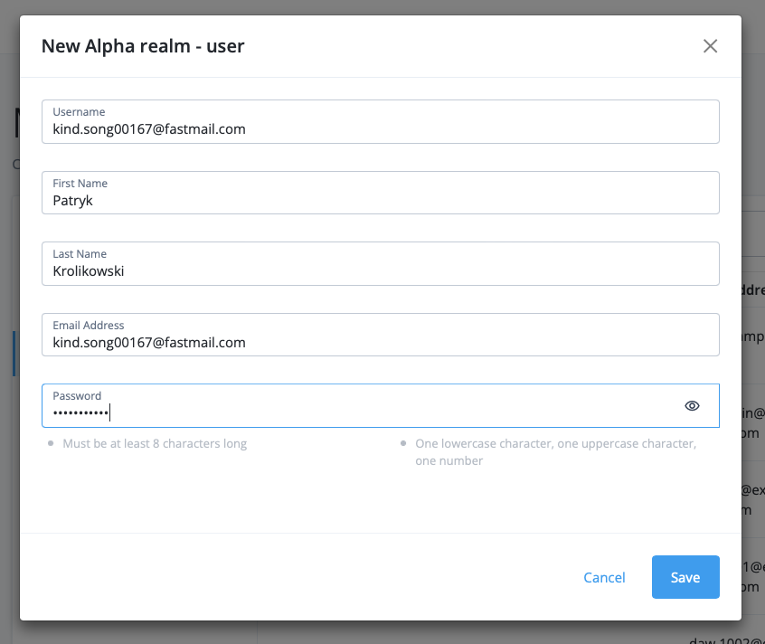

Create a test user
The last thing to do is creating a test user. In order to do so we need to go back to the main Platform UI and go to “Identities”-> “Manage” section:
ForgeRock Identity Cloud — Managed Identities
Then we go to “Alpha realm — Users”, hit “New Alpha Realm User”
ForgeRock Identity Cloud — test user creation
and fill the details.
Note: Please use a “real” email address as Azure AD B2C will want to send a confirmation email to that address during the initial Azure AD B2C User Flow.
ForgeRock Identity Cloud — user creation form
With that, we are ready to move on.

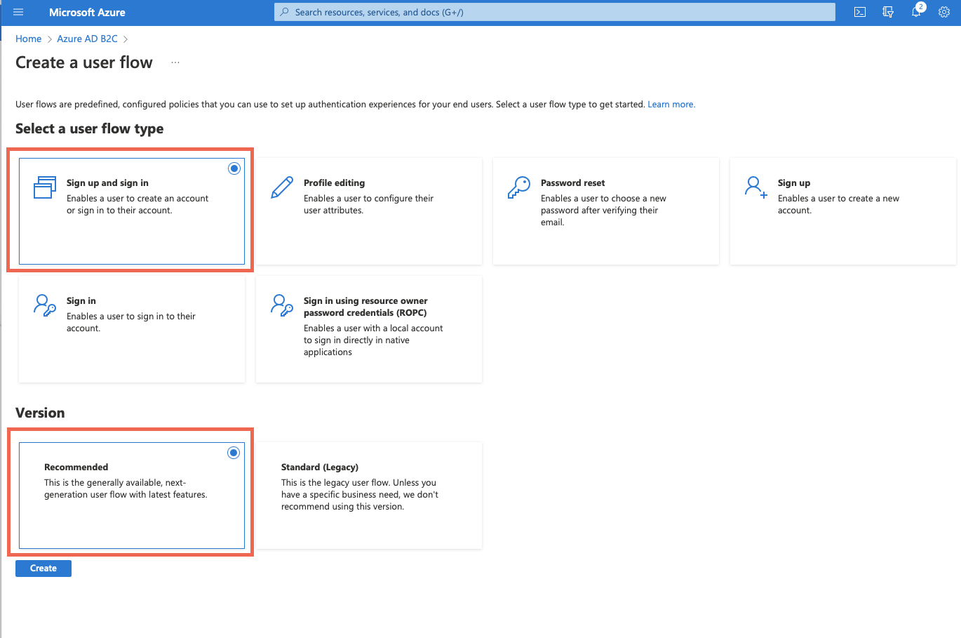

Create a User Flow
Now we need to configure a user flow that will bring the web application and our Identity Provider together.
Go to the main page of Azure AD B2C config. Under “Policies” click “User flows” → “New user flow”:
Create a new User Flow
Then from the list of flow types select “Sign up and sign in” plus a “recommended” version of the flow. The reason why we select this particular flow type is we want to register a user with Azure AD B2C if one does not exist when coming back from ForgeRock Identity Cloud.
User flow type — Sign-up and Sign-in and Version
