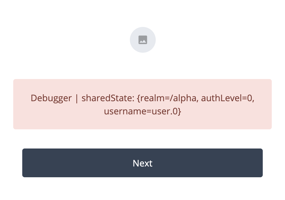

While debugging, you don’t always have to rely on the logs. You can save your error in an available object and carry on with the execution. Then, at some point, you may be able to have the saved content included in the user agent response.
For example, in the scripted decision environment, you can include debugging information in a browser response with the help of a special binding, callbacks; or, you can preserve it in a custom error message that will be displayed at the end of an unsuccessful authentication. Examples of these approaches could be found in the Scripted Decision Node > Debugging section of this document.

sharedState, the object that holds the state of the authentication tree and allows data exchange between the stateless nodes, as described in Storing Values in Shared Tree State. The binding is derived from the TreeContext class’ sharedState field.
A node may expect some inputs and may be expected to save certain outputs in the sharedState object.You can see what the object contains by logging out its current content:
JavaScript or Groovy
logger.error(sharedState.toString())
ERROR: {realm=/, authLevel=0, username=user.0}
What you see will depend on what the preceding nodes in the tree have already added to sharedState. In the example above, only the Username Collector node was used thus far, and predictably, it had captured the username. An individual property could then be obtained and/or inspected via the binding’s get(String key) method:

The logger object is your best debugging friend, but not the only one:
- Callbacks
If you need an immediate feedback without completing the authentication journey, you can display the debugging content with a callback.
For example, you can use javax.security.auth.callback.TextOutputCallback. In a simplest case, you’d display the stringified content of an object:
JavaScript
var fr = JavaImporter(
org.forgerock.openam.auth.node.api.Action,
if (callbacks.isEmpty()) {
action = fr.Action.send(
new fr.TextOutputCallback(
fr.TextOutputCallback.ERROR,
sharedState
).build()
} else {
action = fr.Action.goTo("true").build()
Groovy
import org.forgerock.openam.auth.node.api.Action
import javax.security.auth.callback.TextOutputCallback
action = Action.send(
new TextOutputCallback(
).build()
} else {
action = Action.goTo("true").build()

As an alternative, to receive a quick feedback from your authentication journey, you can use debugging techniques outlined in details for the scripted decision type:
- Displaying debugging information with the help of callbacks
- Including debugging information in the custom error message
For example, to show an object content on the client side in a scripted decision, you can use javax.security.auth.callback.TextOutputCallback:
JavaScript
var messages = "Debugger"
messages = messages.concat(" | sharedState: ", sharedState.toString())
messages
).build()
} else {
