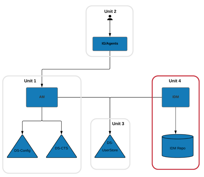

Traditionally, ForgeRock® Identity Management (IDM) upgrades are handled either in-place or by leveraging the migration service. Both approaches require removing the IDM instance from update traffic. This will be suitable if the migration can complete in a reasonable time, often overnight, when load is at its lowest. But, there will be a point where a large enough dataset will incur a migration time which exceeds the organization’s expectation. Running a migration while updates are still applied will not help. Firstly, the resulting data in the new instance will likely be inconsistent. Secondly, running a second migration to include the missed updates will last the same time, and will never converge, since it will scan over the same source dataset again.
This article proposes a solution whereby successive incremental migrations are performed under live traffic, each time reducing the source dataset, until the last migration—off update traffic—can be completed within an acceptable window. It is based on updating a timestamp column for each database update, in which the timestamp is then used to craft a source query to scope down the source dataset to an acceptable time window for the last migration with downtime.
There is a catch, though. All DELETE requests will be missed, so this method is applicable if you can ensure there won’t be any during the migration. If not, then it is still possible to recover the missed deletions, and this is explained at the end of the article.
This is an alternative to the method exposed in this article (LINK) IDM: Zero Downtime upgrade strategy using a blue/green deployment.
