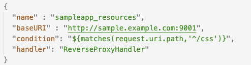

Let static resources pass through
Add a route to pass through CSS and other resources for your sample
application. To do this, create a file named static-resource.json with
the content below, and place this into your routes folder.

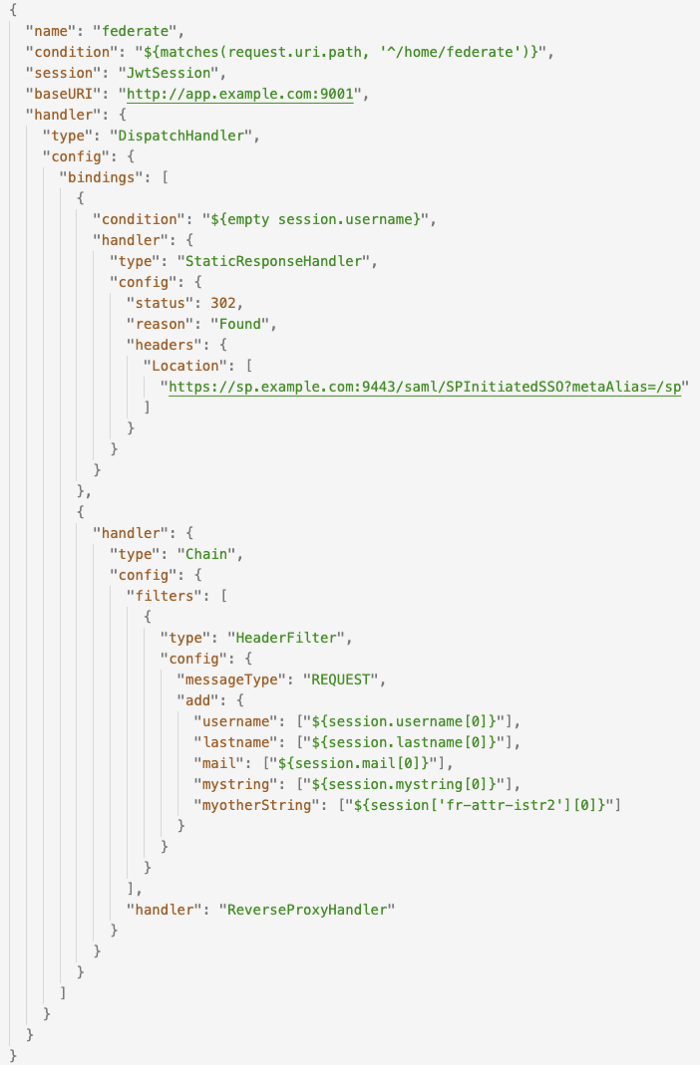

Configure an SP-initiated SSO endpoint
Add a federate route to direct traffic to the SP-initiated SSO endpoint. To do this, create a file named federate.json, as follows:
If no session is detected, this route will direct traffic to the SAML federation handler route. Once established, it will pull values from the session context and add them as headers in the request to the backend application.
Notice that when the HeaderFilter adds headers to the request, they are easily referenced by the attribute name in the session context, i.e., $\{session.username[0]}. However, fr-att-istr2 needs to be referenced differently because it contains the dash character, i.e., $\{session['fr-attristr2'][ 0]}.
