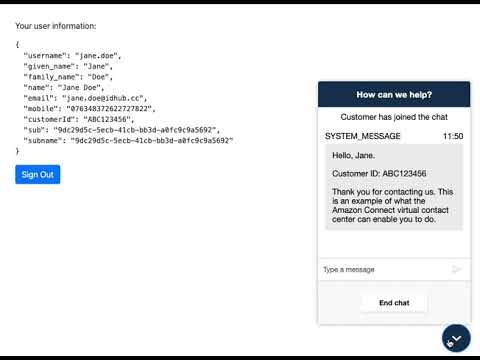

A video demonstration is included at the end of this article to help guide you through testing the instructions.

Token acquisition sequence
  1. On startup, the chat widget is configured with a callback which first calls the ForgeRock token manager for an access token.
  2. If the user is already logged in to the app, the token manager will return the stored access token immediately. Otherwise, the token manager requests an access token from ForgeRock Identity Cloud.
  3. ForgeRock Identity Cloud ensures the user is authenticated to the level required, then returns an access token to the token manager.
  4. The token manager returns the access token to the chat widget.
  5. The chat widget continues the callback process, presenting the acccess token to the JWT issuing endpoint in Identity Cloud.
  6. The JWT issuing service verifies the access token, extracts the subject information to build an Amazon Connect-compliant contact JWT, and returns the JWT to the chat widget. The authentication callback is now complete.
  7. The chat widget initiates the chat session with Amazon Connect, including the contact JWT in the request headers.

Step 5: Try it out!
Here is what the chat widget looks like in action. This is using the sample single page app from the ForgeRock JavaScript SDK. This just a stub app, so go easy on the looks.
The video (below) shows the user first being authenticated by ForgeRock Identity Cloud to get into a portal app. In this case, we’re not bothering the user for their userid or password—we’re just remembering them from before and doing a quick device check.
The portal app does exactly one thing; i.e., a printout of who the user is. We have embedded the Amazon Connect chat widget in the page; when clicking on the chat icon, the widget acquires a token from our custom JWT endpoint, and sends this along to the Amazon Connect platform, which can then display the user’s first name and customer ID.
https://backstage-community-prod.storage.googleapis.com/original/1X/4e1e508bc28fb18b087a2479dfa86609c8b9c75f
